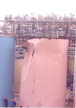

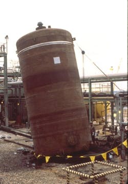

Over-pressure caused a sudden drastic failure at the base of a 12-ft-dia., 24-ft-high fiber-glass acid tank (Figure 1). The tank was equipped with a separate vent line, an overflow line and a vacuum breaker.
As a safety precaution when repairing an underground sewer line that would receive acid if the tank overflowed, supervision had the overflow line blinded and instructed operators to run the vessel well below the overflow line. The thought was that the vent line was sized sufficiently for filling purposes.
Unfortunately, a blind from a previous job had been left within the vent line and wasn't detected. As operators started filling the fiber-glass tank, the inerts had no place to go and the tank was pressurized to destruction. Fortunately, no one was injured [4].
Under-pressure led to a well-maintained low-pressure 20-ft-dia., about-30-ft-tall carbon-steel solvent tank with ¼-in. walls ending up as scrap metal after "improvements" to the vent system. To reduce emissions, vent recovery compressors and more-sophisticated instrumentation were replacing old-style conservation vents.
While the first batch of material after the tank conversion was being pumped out, the roof and two courses of vertical walls were sucked in due to the lack of the nitrogen padding and the vacuum protection system being inadvertently isolated by a small block valve.
A simple hinged vent lid had served well for decades. The lid was replaced with a much more complex system involving a vent compressor to recover the vapors and a nearly zero leakage pressure/vacuum device. The operators were well trained on the new compressor but not on the new piping arrangement. Worse yet, closure of a single small-diameter impulse valve rendered all the well-conceived improvements worthless. Oops, a $100,000 mistake [5].
Plant designers must strive to develop user-friendly piping, layout and control schemes, and must clearly label equipment safety systems to reduce opportunities for failure. Venting systems should ensure proper protection during all phases of operations.
