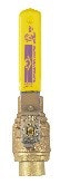

Milwaukee Valve Company's BA-100/150 NSF Bronze Ball Valve has received certification for achieving the standards of ANSI/NSF Standard 61 for potable water. The BA-100 NSF (threaded end) and BA-150 NSF (solder end) are the first domestic bronze ball valves to meet this rigorous standard, as certified by the independent testing labs at Underwriter Laboratories (UL).
The BA-100/150 NSF is available in sizes ranging from 1/4'' to 2''. Standard features include glass-reinforced PTFE seats for high-temperature applications and no-leak reliability. And they come complete with a blow-out proof stem and adjustable stem gland. Rated at 600 WOG/150 SWP though 2”, these valves are dependable for a wide variety of applications. They also conform to the standards of WW-V-35B, MSS SP-110 and are built with superior ASTM-grade materials of construction.
ANSI/NSF Standard 61 has been developed in response to amendments to the U.S. Safe Drinking Water Act (SWDA), which requires that pipe, fittings and fixtures be lead-free. The BA-100/150 NSF also satisfies the lead-leaching standards set in NSF-61-8 for end-point devices (faucets), as stated in section 9.  This more-stringent measurement guarantees safe use of the BA-100/150 NSF in drinking-water applications.

The basic design of the BA-100/150 NSF features complete machining of all water-contact surfaces. This standard machining reduces the potential for lead to leach from the casting. No secondary manufacturing operations, such as acid baths, coatings or other chemical treatments are required for Milwaukee Valve to meet ANSI/NSF Standard 61.
