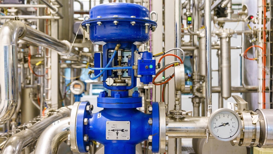

Control valves play a critical role in keeping a process operating properly. A control valve should respond reasonably quickly — not too fast or too slow — to signals from the controller or distributed control system (DCS). Unfortunately, malfunction or misapplication of this relatively low-cost item has caused many unsafe events, some with catastrophic consequences.
Control Valve System
Figure 1. The number of relevant subsystems varies depending upon the type of problem.
Control valve problems arise from a wide variety of sources. A troubleshooter must strive to identify the actual source quickly and limit its impact. This paper presents a systems approach for minimizing both design issues and operating problems of control valves.
A systems approach is strategic and intuitive — and broadly applies not only to control valves but also to myriad other operating and control systems. Figure 1 shows a systems view of a control valve and its subsystems.
Simply put, issues with any of the subsystems or their interactions could cause a control valve to malfunction. Although the figure shows six subsystems, the actual number can vary depending on the nature of the problem. Here, though, let’s look at these six subsystems to examine their potential problems and how to avoid them.
