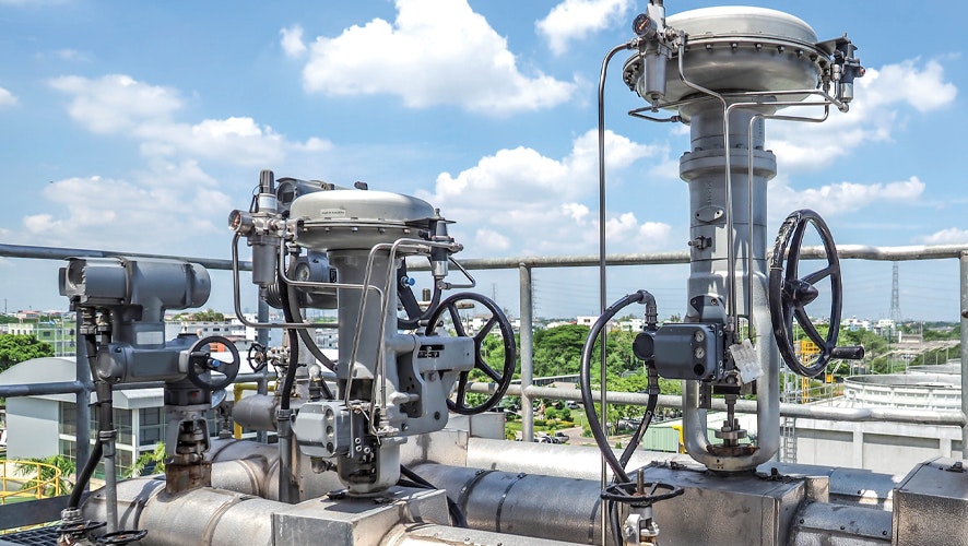

The International Society of Automation (ISA) working group responsible for ISA TR 96.05.01 2008 edition on partial stroke testing of automated valves published an update to the original technical report (TR) in late 2017. This latest edition resulted from a lengthy process that included input from end users, valve and actuator original equipment manufacturers, process safety engineers, valve maintenance providers, engineering service companies and consultants. Feedback from end users around the industry has been positive.
Although not containing mandatory requirements, the updated TR is very informative and a must-read for engineers responsible for automated-valve test programs.
The update introduces concepts that were not widely deployed when the 2008 version was issued. These reflect the evolution of more stringent process safety standards and effective proof-testing schemes for critical automated valves, testing and analysis methods. Experience gained from initial partial stroke testing (PST) implementations and automated online valve testing programs revealed key concepts that should be factored into PST and other valve proof-testing programs designed to support process safety objectives.
The most important addition is the concept of margin. Margin is a term familiar to valve and actuator manufacturers as well as valve test engineers; it is a critical performance parameter when assessing any valve’s ability to perform as designed. Simply put, margin is the difference between the force that must be exerted to move the valve closure member to its required position and the capacity of the installed actuator to provide the force needed to make that happen, i.e., capacity – requirement = margin.
The concept of margin is similar to the concept of safety factor that often is specified for new automated valves. However, safety factor is the design objective while margin is the actual result. Theoretically, margin should equal safety factor when the automated valve is brand new. After some time in service, the expected degradation mechanisms, which provided the basis for the target safety factor, will start to affect valve performance and margin will decrease.
An automated valve normally will be considered capable of performing its intended function as long as margin remains equal to or greater than zero. Both actuator capacity and valve operating requirements change due to service conditions and, as a consequence, functional margin degrades. Therefore, PST and other proof-test approaches for demonstrating that automated valves remain capable of performing critical functions on the next cycle or at some point in the future must be capable of assessing the margin condition.
