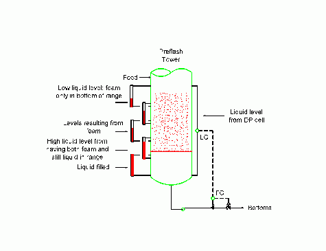

The second method suits towers with multiple sight glasses. Figure 1 illustrates foaming in a petroleum crude pre-flash tower that has multiple sight glasses and taps installed due to the level range (over 40 ft.). Pre-flash towers in this service should have large liquid inventories to break the foam to prevent entrainment and pump problems. The still liquid in the sight glasses has a lower height than the foam inside the tower. Multiple sight glasses show liquid levels at different elevations. Each liquid level is really a measure of foam density at that elevation. This is a clear indication of foaming and is a powerful troubleshooting tool.

In all of these methods, you must check how the sight glass or sample connects to the vessel. Stilling wells inside the vessel can confuse the observations, because they prevent foam from getting to the sight-glass connections or the sampling taps.
