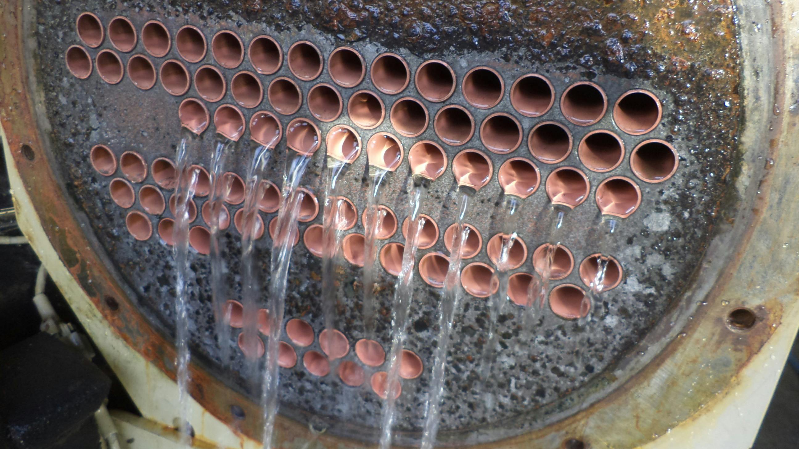

Fouling in a cooling water exchanger can occur on either side of the exchanger. Most often, cooling water is on the tube side of a typical shell-and-tube exchanger. This is because the most fouling-prone service travels through the tubes because the velocity is higher. If the velocity is too low, deposits can form, leading to fouling. It is common for trash — yes, literal trash like potato chip bags, bottled water caps, shoelaces, you name it — to settle in an exchanger, especially if the cooling water is on the shell side and must navigate around baffles. If the velocity is too high, corrosion can form, but that can be managed by tube metallurgy and cooling water chemical treatment.

A visual inspection during a planned outage can show significant fouling on the cooling-water side of the exchanger tubes. Deposits will consist of a combination of:
  • Biological growth
  • Corrosion byproducts
  • Mineral scale deposits
  • Suspended solids accumulation
The fouling layer acts as an insulating barrier between the process fluid and cooling water, reducing the exchanger's heat-transfer capacity.
