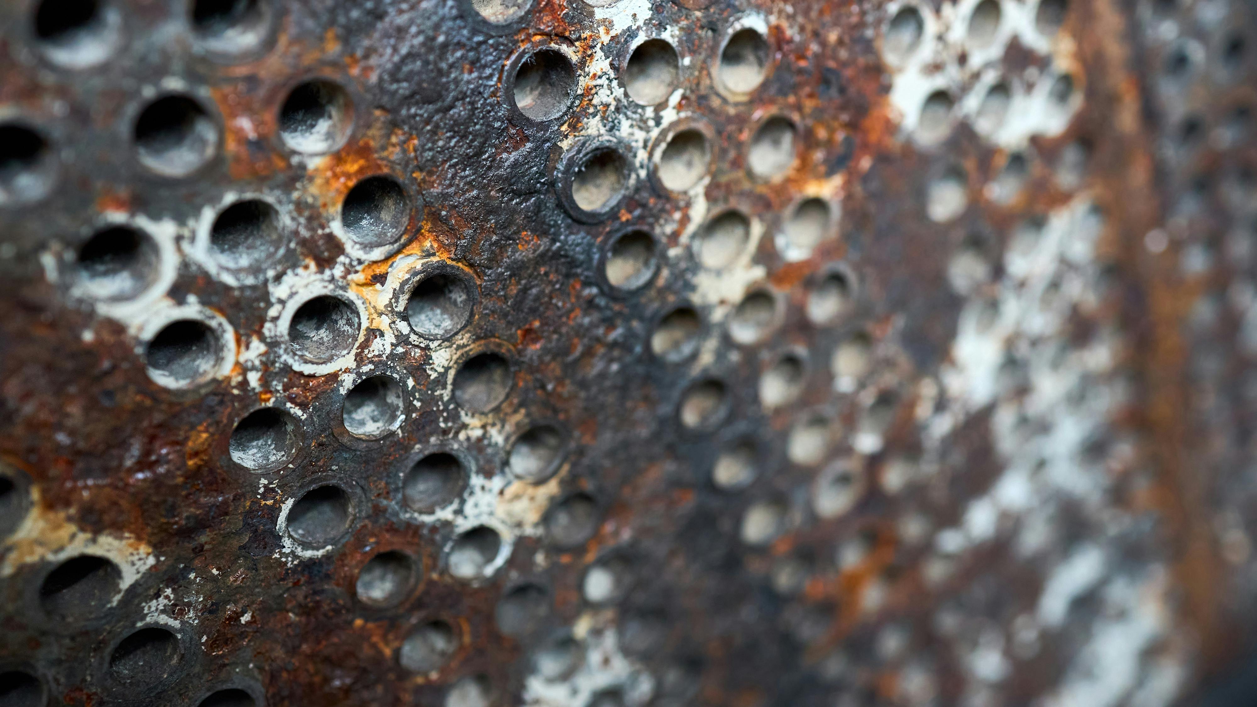

Carbonic Acid Corrosion
A common issue in condensate systems is carbonic acid corrosion. Carbon dioxide that enters systems through air in-leakage or comes from carryover of decomposed bicarbonate alkalinity with steam will dissolve to form carbonic acid.
CO2 + H2O ⇌ H2CO3 (1)
While H2CO3 is not a strong acid, it can cause considerable damage, as evidenced in Figure 1.
Not only is direct corrosion a result, but iron oxide particles generated by the attack will travel to steam generators and precipitate on boiler tubes. The precipitates increase the potential for under-deposit corrosion.
