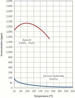

A factor that exacerbates the scaling potential is calcium carbonate’s inverse solubility with temperature. Per this effect, Equation 1 above can be modified to:
This influence, along with that of gypsum, is illustrated in Figure 2.

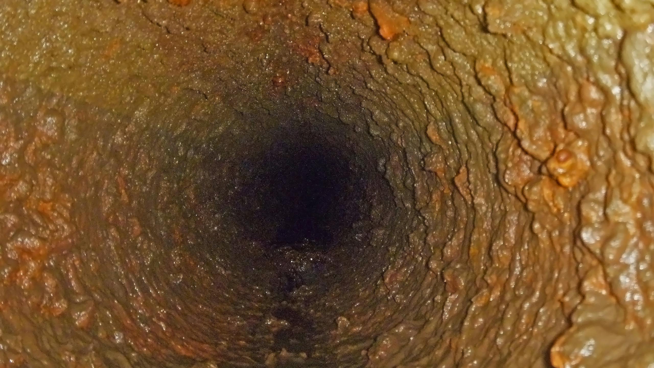

An everyday example of this reverse solubility occurs in home plumbing systems, where hot water lines and showerheads accumulate calcium carbonate deposits (often incorrectly termed “lime scale”). The deposition can be very pronounced in industrial heat exchangers.
Figure 3 shows calcium carbonate scale in an extracted portion of a steam surface condenser tube.

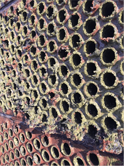

A vivid example of potential problems is shown in Figure 7 of a two-pass tube-and-shell heat exchanger, whose cooling water at the time was treated with a traditional phosphate-phosphonate program.
At the inlet end (the lower half of this heat exchanger), corrosion was problematic. At the warmer outlet side (the top half), deposition was an issue. So, the phosphate treatment program was not particularly effective for either corrosion or scale control.
