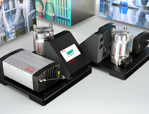

With the Turbolab Core, Leybold launches a small, plug-and-play high vacuum pumping system for research, laboratory and industrial applications. Within the Turbolab series, the compact tabletop unit fills the gap for entry-level vacuum needs that require a clean, dry, stable high and ultra-high vacuum. The Turbolab series is now available in a total of five variants covering the complete application spectrum for R&D and analytical applications.
The ergonomic system is made up of Leybold components including the oil- and maintenance-free Turbovac i turbomolecular pump, the Divac 1.4 dry diaphragm backing pump and a simple controller, providing users with easy serviceability. The robust, low-noise high-vacuum system is geared to the specific ambient conditions of laboratories and research facilities. The compact pumping station frame stands on rubber feet to prevent the transmission of vibrations when it is placed close to a microscope.
The operation and the control of the Turbolab Core are reportedly intuitive and user-friendly. The controller also serves as a speed and pressure display. Optionally, the Turbovac i and the backing pump Divac can be started up with a time delay or pressure-dependent.
