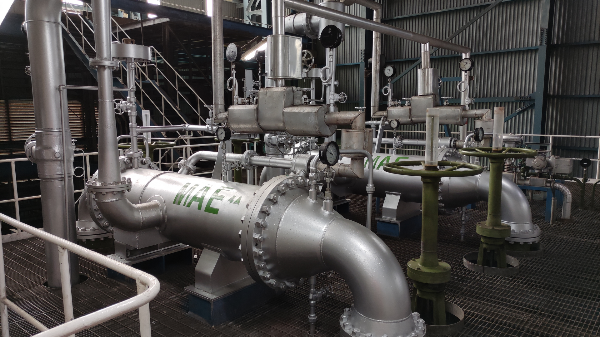

Recently, a petrochemical company wanted to look at replacing individual vacuum systems used in multiple parts of the plant with a central vacuum system. The most common vacuum devices in chemical processing environments include vacuum ejectors or liquid-ring vacuum pumps. Both can be considered as compressors drawing gas from a closed system and discharging it to a higher-pressure destination.
This client was using many small ejector systems and wanted to switch to a centralized liquid-ring pump system. The benefit for this change would be reducing steam consumption and lower CO2 emissions by shifting away from the steam-driven ejectors and toward the electric motors on the liquid-ring pumps. This example highlights the advantages and disadvantages of both systems, including implementation challenges.

Most ejector systems use steam as the motive fluid to provide vacuum. The ejector system consists of the ejector, the condensers and condensate handling. In contrast, the liquid-ring vacuum pump uses a motor to operate a positive displacement compressor using a liquid ring to move the process gas. The liquid-ring system requires a discharge separator, plus liquid handling that might include cooling, liquid cleaning and liquid cooling.
Lower suction pressures, typically below 45 mmHg pressure, favor ejector systems. Higher discharge pressures, typically above 3 PSIG, favor liquid-ring systems. Additionally, availability of thermal energy (steam) favors ejectors.

Based on having one common vacuum system, the new liquid-ring system would require two parallel 50% capacity units of the largest liquid-ring compressor I would recommend using. This was going to be a large, high-energy system with a large potential for operating problems. Issues on a common system would potentially shut down the entire plant.
My final recommendation was to avoid a fully common system. Splitting users into groups with similar suction pressures in each group reduced liquid-ring pump size and power needed. Since systems can run at different pressures, the client didn’t have to pull the entire system down to the lowest system pressure.
Even with the power dropped by using multiple liquid-ring systems, the energy economics for this location were roughly neutral. The operating cost for boiler production of steam was roughly equal to the cost of electricity. However, the plant needed to make significant investments to replace a working vacuum ejector system with a working liquid-ring system.
