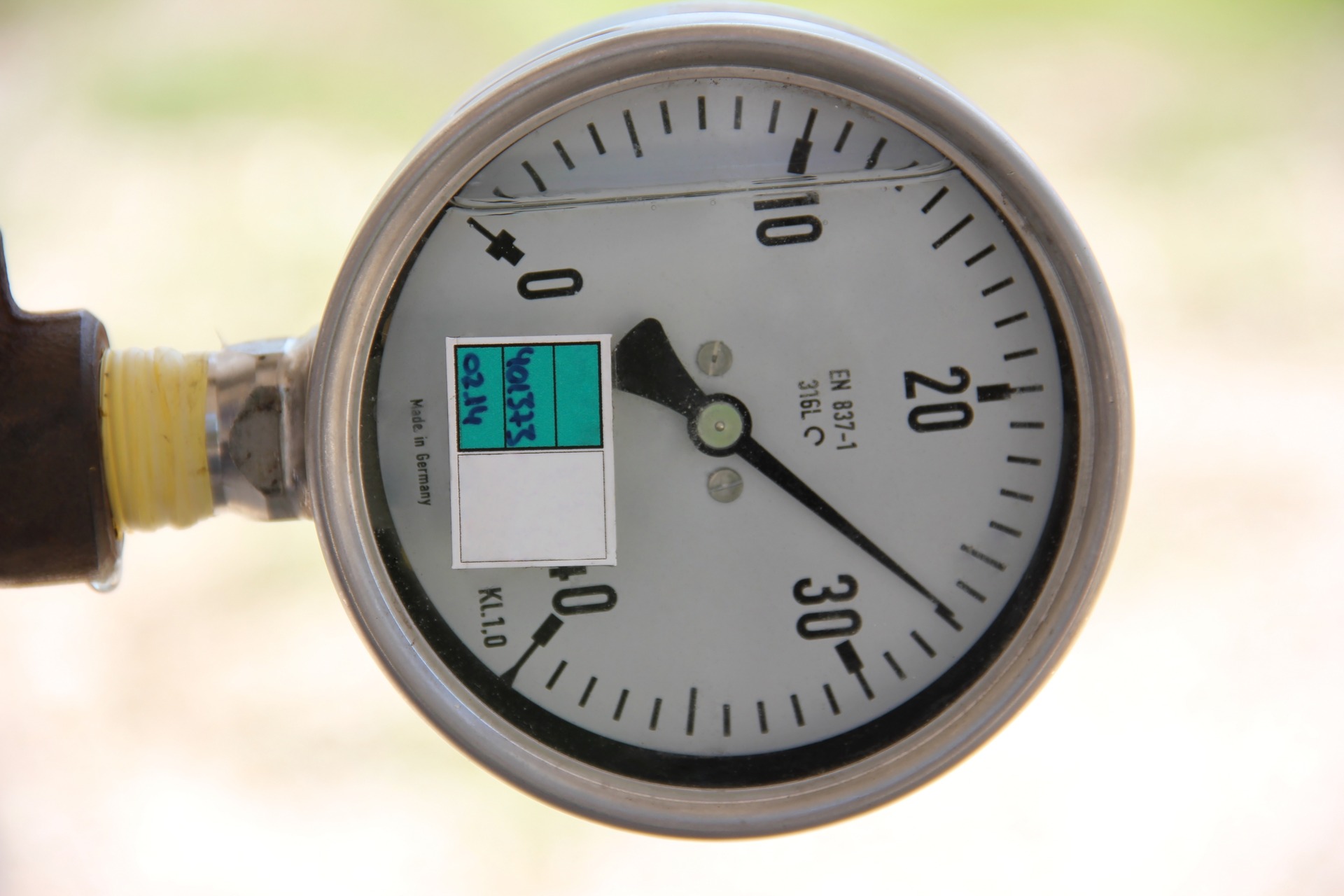

Just discussing vacuum system operation led to massive confusion. The unit operators tended to talk in terms of inches of mercury, but the unit engineers liked to use millimeters of mercury. At first glance, a simple 25.4 conversion factor should convert inches to millimeters. However, it doesn’t. In most plants, including this one, inches of mercury is the pressure below atmospheric pressure and millimeters of mercury defines an absolute pressure.
For inches of mercury, the relationship to absolute pressure is:
Absolute pressure = barometric pressure - vacuum (in inches of Hg)
Feeling the Pressure
If we start assuming that barometric pressure is a standard atmosphere of 29.92 inches of mercury (14.696 psia), then a pressure of 28 inches of mercury (from barometric) would be an absolute pressure of 1.92 inches of mercury (29.92-28) or an absolute pressure of 48.8 mm of mercury.
Unfortunately, the story doesn’t end here. The key element is the assumption that barometric pressure is a standard atmosphere. Variations in local pressure can cause problems. If the pressure reading, either in the plant instrumentation or on the local gauge, is an absolute pressure reading or is compensated for the actual local pressure at the time of the reading, then there isn’t a problem. Fortunately, most plant vacuum instrumentation uses either absolute pressure gauges or does include compensation. That’s also true of many modern portable instruments used to measure vacuum pressures.
However, it’s not always true. Uncompensated readings can have significant errors. Local air pressure varies with both weather and elevation. For example, as I write this column, the barometric pressure variation just due to normal weather in Houston over the last 72 hours was 764 mmHg to 774 mmHg. For the previous example of 28 inches of mercury, this is equal to a variation of over 20% of the vacuum pressure if the pressure readings are not compensated.
Another example would be a plant in Denver. The local pressure in Denver averages around 638 mmHg absolute (25.1 inches of mercury absolute). Taking an uncompensated reading in Denver would have an error of over 100%.
