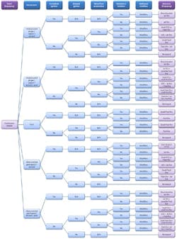

The third step is an event tree and frequencies. The event tree (see Figure 2) is from the Singapore guidance document.
The event tree has been reduced (see Figure 3) to eliminate fire as a possibility. The concern is asphyxia and inhalation of either chlorine or ammonia.
