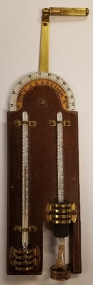

An essential concept for cooling-tower design is that of "wet bulb" temperature. Consider being outdoors in the shade on a 90°F day at 40% relative humidity at sea level. A standard thermometer would read 90oF, which is the "dry bulb" temperature. The device shown in Figure 4 is an example of an early psychrometer. It has both a plain thermometer and a second thermometer with a piece of cloth covering the bulb that is soaked with water before use.
The psychrometer is on a swivel and can be swirled rapidly through the air. The instrument is appropriately named a “sling psychrometer.” After swirling the device for a short time, the dry-bulb thermometer will still read 90°F, but the wetted thermometer will read 71.2°F.
This latter reading is the wet-bulb temperature and is the lowest theoretical temperature that can be achieved by evaporative cooling. Modern psychrometers are mechanically aspirated (fans move the air across the wetted wick) and are more accurate.

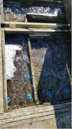

In crossflow towers, the return water is typically discharged onto a distribution deck with uniformly spaced nozzles within the deck that allows the water to feed by gravity onto the fill.
Logic of course suggests the importance of keeping all nozzles clear to maintain uniform flow to the fill. In this case, an added problem may arise from algae that can proliferate in sunlit areas of the tower. Covered decks are common to minimize algae growth.
