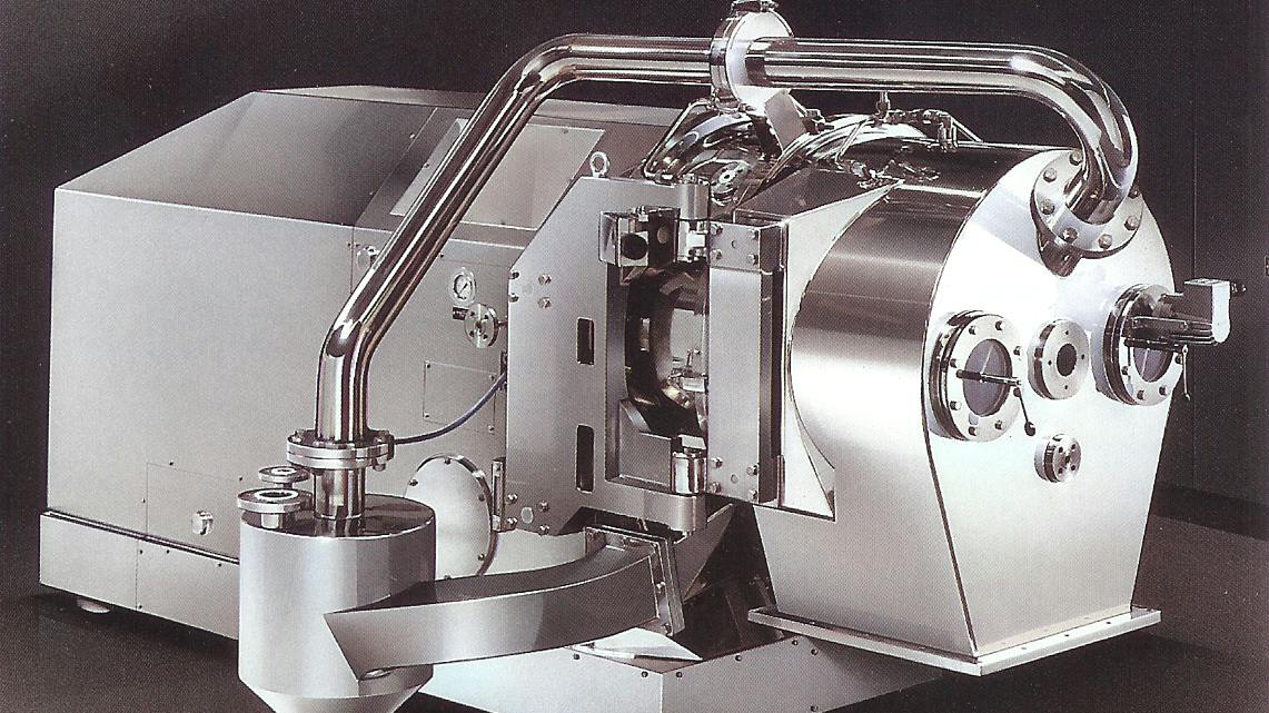

Horizontal Peeler Centrifuge
This design has a perforated basket mounted on a horizontal axis; a peeler knife shaves the cake off the filter media lining the basket wall while the basket is still spinning at reduced speed, enabling fast, largely automated discharge. This gives the shortest cycle times and highest throughput of the three centrifuge types, making it a workhorse for large-volume API or bulk chemical production. The trade-off is mechanical shearing of the crystals from the peeling action, which can cause particle attrition or fines generation of fragile or friable crystals— not ideal in certain applications. Horizontal peelers historically originated and dominated in Europe, which is why they are conventionally sized in millimeters — common basket diameters include 630 mm, 800 mm, 1,000 mm, 1,250 mm and 1,600 mm (with some suppliers offering baskets up to 2,000 mm). Mechanically, horizontal machines run smoother than vertical baskets — much like a front-load home washing machine versus a top-load unit — because the rotating mass (wet cake) are better distributed and balanced along a horizontal axis, which also tends to provide better wash efficiencies.
