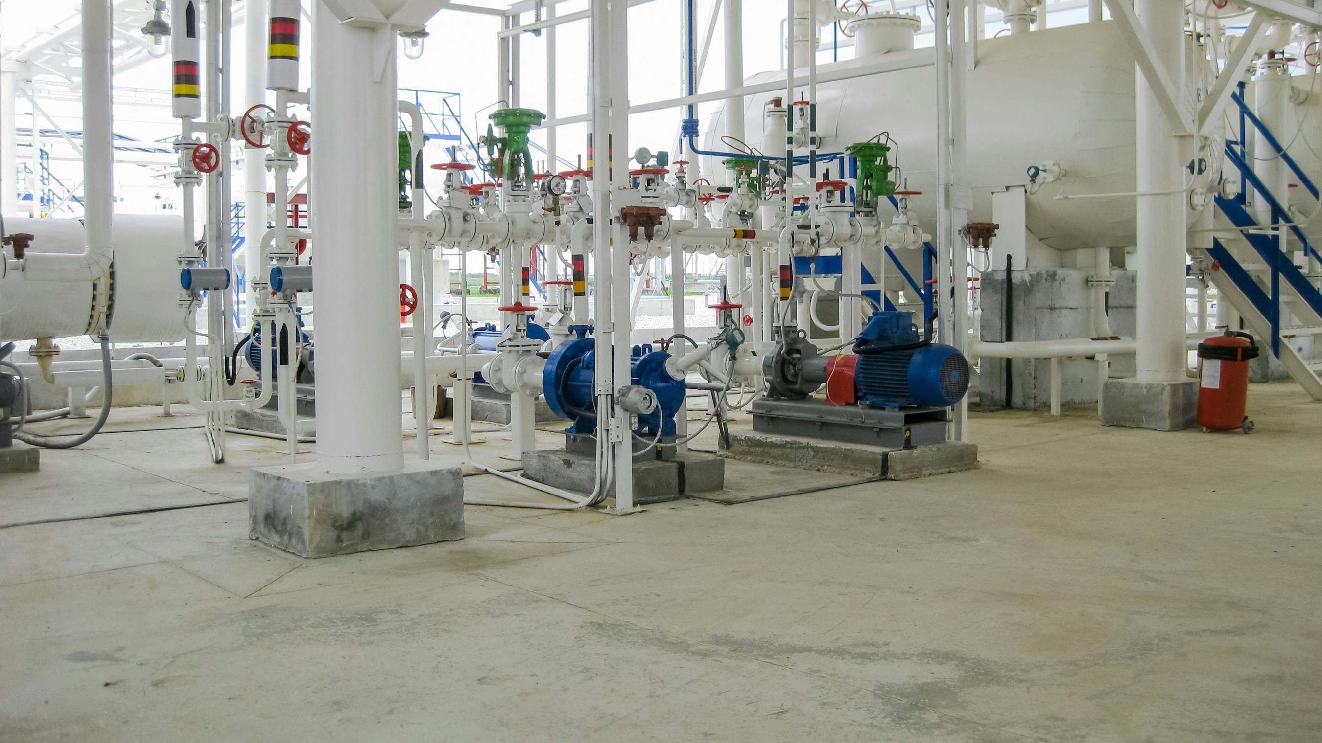

One of the most important aspects of pump operation is its interaction with upstream and downstream components. This interaction significantly affects the pump's performance, reliability and overall operation. Unfortunately, this aspect is often overlooked, leading to poor performance, operational issues and reduced reliability. Even if the highest-quality pump is selected for an application, neglecting its interaction with associated systems can result in operational problems, damage and failures.
For example, issues can arise when the system forces the pump to operate far from its best efficiency point (BEP) for long periods or when poor suction piping configuration leads to cavitation.

Chemical processing plants commonly use horizontal pumps. However, some applications require large pumps in limited spaces, necessitating vertical pump installations. Engineers typically prefer horizontal pumps unless suction conditions or space/budget constraints dictate otherwise. Vertical pumps provide compact and cost-effective solutions for specific applications.

The function of suction piping is to supply an evenly distributed flow of liquid to the pump suction nozzle, with sufficient pressure to the pump to avoid excessive turbulence or cavitation. Suction problems can result in cavitation, poor pump performance, low bearing life, mechanical seal failures, high vibration and many more. In extreme cases, vibration produced due to suction problems can cause fatigue failure of pump parts, piping and appurtenances. The cavitation and gas lock, or air lock, can lead to many pump problems and failures. Adequately size suction piping and properly configure it to avoid cavitation and gas/air entrainment.
For suction piping, limit the liquid velocity to values below those where turbulences would occur or bubbles would rise through the liquid.
Also, maintain a minimum velocity to prevent solids from settling if the liquid contains any solid particles or contaminants. As a rough guide, aim for suction piping velocities between 0.7 and 1.3 m/s. Size the suction piping at least one or two sizes larger than the pump's suction flange for many pumps. Lay out the piping correctly to eliminate gas or air pockets, gas-lock and other adverse effects.
The suction piping should be as short and simple as possible to prevent the accumulation of gas from the liquid being pumped. Arrange the suction piping without any bends. If bends are necessary, try to minimize them, and use long-radius bends or long-radius elbows. An important factor for suction piping is to reduce turbulence at the suction particularly immediately to the pump suction nozzle.
Keep the amount of turbulence and entrained gas at a minimum. The liquid flow is further complicated when elbows or tees are located adjacent to the pump suction nozzle (2). In this scenario, uneven flow patterns or vapor separation keeps the liquid from evenly filling the impeller leading to operational problems and reliability issues (3). A straight length of pipe is needed in front of (any centrifugal pump. As a rough indication, install a straight length of pipe equal to six times the pump inlet size (“6×D”). Some specifications or manufacturers recommend “8×D” or even “10×D” for this straight length.
