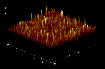

The membrane is made of a polyamide thin-film composite. An atmospheric pressure plasma creates active sites on its surface that then are used to initiate graft polymerization to create a "brush layer" of polymer chains anchored to the surface that are constantly in motion (Figure 1).
Fouling-Resistant Surface
Figure 1. Both surface chemistry and topography of membrane can be tuned to achieve the desired level of performance.
