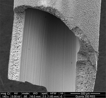

The membrane consists of a layer of carbon fibers on a ceramic support that has minimum pore sizes of 30 nm (Figure 1). Tested in RO, MD and FO desalination processes, it achieved 100% salt rejection and as well as the high freshwater flux.

Figure 1. Structure consists of a network of carbon fibers deposited on a porous, hollow ceramic tube. Source: Zhiping Lai, KAUST.
