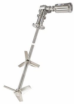

Admix launches RotoMaxx II, an all stainless steel, low speed, large capacity sanitary mixer. The design features a right angle helical bevel gearbox that performs in demanding operating environments. The large capacity agitator reportedly meets stringent 3-A compliance and clean-in-place standards for the food, beverage, pharmaceutical and cosmetic industries.
The modular design of the RotoMaxx II features:
- Capacity up to 60,000 gallons.
- Multiple shaft diameters, and shaft lengths up to 144”.
- Horsepower up to 15 HP.
- Components that protect the gear drive from shock loads and dampen vibrations.
RotoMaxx II uses mixing impellers that promote high flow and rapid mix times and are suited for product batches up to 60,000 gallons. Standard units use Jetfoil impellers, which provide pumping rates that may be 200% greater than conventional blade impellers with lower power consumption, according to the company.
