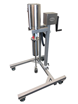

Admix, Inc. introduces the newly redesigned RS-02 Pilot Scale Mixer. Suitable for pilot plants and small-scale production, the Admix RS-02 high shear pilot scale mixer offer processors an option for product development, formula optimization, trial mixtures and small production runs.
The RS-02 redesign includes a mobile lift stand with a wider base for added stability and a large, hand crank for easily adjusting mixer height. The portable unit fits through standard width doorways making it easier to transport it within a plant’s product development test labs and production areas. The RS-02 has a batch capacity of 5-20 gallons/19-75 liters and incorporates the Admix Rotosolver high shear mixing impeller for wetting out and dispersing powders. Its patented design is engineered to provide the optimal balance between shear and ­flow so that mixtures are completely homogenous, emulsified and agglomerate-free in under 10 minutes.
