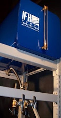

The IFH Group now offers a special product package version of its fluid storage and dispensing system that that is said to improve lubricant storage by providing a better way to handle all kinds of oils, lubricants and industrial fluids that is easier, safer, cleaner, and more cost efficient than 55 gallon drums.
The special product package is designed for applications involving corrosive chemicals and other abrasive fluids that require special handling for safety and efficiency. The standard PVC sight gauge on the front of the steel containers is replaced with a glass sight gauge equipped with ball check fittings at both ends. Underneath the containers are 3/4" NPT fittings and Flex Steel Hose for resistance to fluids that may damage the PVC hose on standard IFH systems.
The Special Product Package can be supplied with new IFH fluid storage and dispensing systems or as a retrofit to existing systems.
