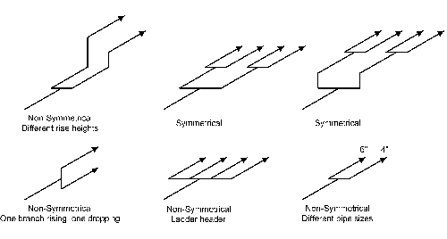

Branched Piping
Figure 1. A symmetrical network is best for distributing liquid in branches.

The situation is relatively simple if the piping network consists of a simple line. Problems occur with downstream branches. If you must distribute liquid through multiple branches, keep the piping as symmetrical as possible. Maintain the symmetry in both the horizontal and vertical planes and at every split. Figure 1 shows several examples of symmetrical and non-symmetrical piping. In non-symmetrical systems the liquid will concentrate toward the last part of the pipe that takes a turn. To avoid symmetry problems, the plant used separate injection points downstream of the last major branch in the line.
