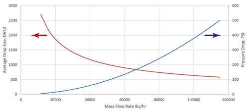

Effect Of Operating Rate
Figure 1. Mass flow rate through a single-fluid spray nozzle significantly affects both pressure drop and average particle size.
Selecting the most-appropriate and cost-effective technology requires thorough process knowledge.

Many processes require sprays to operate effectively over a 1:10 range of rates. Figures 1 and 2 show the impact of operating rate on spray characteristics of a commercially available single-fluid nozzle. Running a single-fluid nozzle over a 1:10 range results in a nozzle pressure drop that varies by a factor of 100 (Figure 1). The pressure drop can be approximated as a squared function of flow rate. Often, more important to process performance is the average drop size, DV50, which varies from 2,700 microns to 500 microns. The process performance of these sprays differs significantly. The drop evaporation time will be approximately 29 times longer for the larger spray (lower rate operation with 2,700-micron drops). The drop trajectory in a process vessel also changes. The high rate spray has a substantially higher velocity that, when combined with the flow rate, results in a much larger energy input as shown in Figure 2. (In a nozzle, the liquid pressure is converted into the kinetic energy of the spray drops.) The change in the energy input may impact the process dramatically. The high velocity sprays induce bulk gas or vapor motion. The additional gas or vapor motion may cause back-mixing and entrainment of sprays in unintended ways. An approximation of this effect can be calculated from the hydraulic power of the spray.

In contrast, selecting a nozzle with a 40-psi pressure drop for the high flow case would result in only a 0.4-psi pressure drop at the low-flow conditions, causing the spray nozzle to drizzle liquid instead of forming a spray.

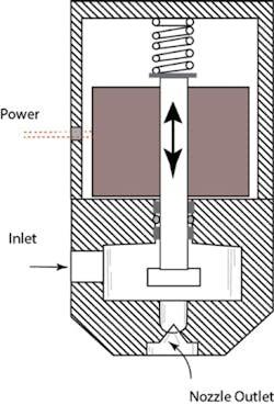

Pulsed Nozzle
Figure 6. A close-coupled solenoid enables rapid opening and closing of the outlet to control the fraction of time spraying occurs.

Pulsed Single-Fluid Nozzle
Pulsing a single-fluid nozzle — that is, rapidly activating and deactivating the nozzle to control the fraction of time it is spraying — enables independent control of flow rate and pressure. A close-coupled solenoid valve acts on the nozzle (Figure 6). When the solenoid retracts the plunger, liquid can spray. The frequency of pulsation varies between the products and manufacturers; it can range from 10 to 200 times per second. The actual flow rate as a percentage of the maximum flow is set via a control unit that supplies the pulsing power to the solenoid valve. The supply pressure must be controlled to set the sprayed flow.
This technology is a relative newcomer to spray options — introduced less than ten years ago. The pulse-width-modulation (PWM) system of spray nozzles (Figure 7) is rapidly gaining traction. It provides a means to maintain the average drop size, spray angle and spray pattern at reduced flows. PWM nozzle systems with controllers provide many advantages for certain applications. For example, adjusting the duty cycle can control the amount of material sprayed onto a conveyor as its speed changes while maintaining the spray parameters.
