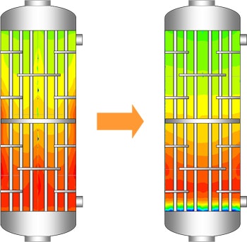

Multi-tubular Reactor
Figure 2. Key design objective is to ensure uniform horizontal temperature distribution to minimize catalyst deactivation. Small adjustments in internal geometry provided better results (right). Source: PSE.

"We have been carrying out model-based optimization of the reactor and separation sections. The key here is the complex multi-tubular reactor, which is difficult to design to give uniform performance across the tube bundle (Figure 2) -- it is also very difficult to model. Poor design leads to unwanted side reactions and the potential for hot spots. So we constructed a flowsheet that included a high-fidelity multi-tubular reactor model and a separation section with many columns, and performed a rigorous economic optimization that maximized annual profit as the objective function," explains Matzopoulos, who adds that PSE specializes in reactor optimization of all kinds.
This model involved 49 decision variables, which is way beyond what anyone has done before, he claims. It included, for example: reactor design decisions such as tube diameter, pitch and quantity; distillation column operating decisions such as reflux ratios and pressures; intermediate stream purities; and configuration decisions such as number of trays.
"The outcome was an improvement in process economics of tens of millions of euros per year -- the result of losing two distillation columns, just one of which had capital and operational costs of €5 million/yr," he notes.
