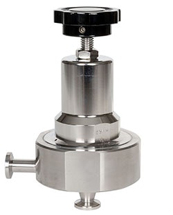

Cashco Inc. introduces the BL1 in-line regulator designed specifically for clean gas applications. At seven pounds, the BL1 can control inlet pressures up to 135 psig. All wetted, metal parts are constructed of 316L stainless steel and are machined to meet SFV-4. All soft goods meet FDA code of Regulations Title 21, Part 177 USP Class VI. The BL1 is available with either 1/2" and 3/4" tri-clamp body connections.
Standard offerings include a 316L stainless steel metal plug and a standard knob mounted on the adjusting screw to adjust set points. An EPDM O-ring, located on the pressure plate, provides additional stability for all flowing conditions. The standard EPDM diaphragm helps extend the valve’s cycle life.
