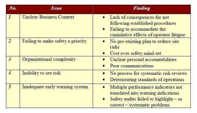

Although the sidebar details the direct causes and consequences of the Isomerization Plant (ISOM) explosion, the underlying reasons are complex. The final Fatal Accident Investigation Report identifies five underlying cultural issues (Figure 1).
Restoring Texas City’s safety and performance requires a comprehensive and far-reaching program going well beyond mere technical refinements. Corrective action must address failings in management, culture and control.

Fifteen people were killed and over 170 harmed as a result of a March 23, 2005 fire and explosion on the Isomerization Plant (ISOM) at the BP Products North America owned and operated refinery in Texas City, Texas.
The incident was an explosion caused by heavier-than-air hydrocarbon vapors combusting after coming into contact with an ignition source, probably a running vehicle engine. The hydrocarbons originated from liquid overflow from [a] blowdown stack (vent and receptacle for collecting liquids) following the operation of [a processing unit’s] overpressure protection system caused by overfilling and overheating of [its] contents.
The failure to institute liquid rundown (discharge flow) from the tower, and the failure to take effective emergency action, resulted in the loss of containment that preceded the explosion. These were indicative of the failure to follow many established policies and procedures. Supervisors assigned to the unit were not present to ensure conformance with established procedures, which had become custom and practice on what was viewed as a routine operation.
The severity of the accident was increased by the presence of many people congregated in and around temporary trailers which were inappropriately sited too close to the source of relief. Many of those injured could have been warned and left the area safely had warning been provided by those who were aware of events. It is unclear why those aware of the process upset failed to sound a warning. The likelihood of this incident could have been reduced by discontinuing the use of the blowdown stack for light end hydrocarbon service and installing inherently safer options when they were available.
The investigative team found no evidence of anyone consciously or intentionally taking actions or decisions that put others at risk.
