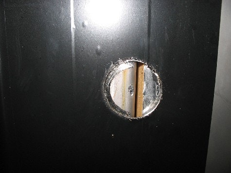

It is fairly obvious to use a camera to examine furnaces and ovens for heat loss. However, thermography also can offer insights for cooling equipment. For instance, a new process freezer for removing heat from cooked meat patties exhibited numerous areas of condensation on its exterior surface, indicating voids in the insulation system in the walls. The manufacturer drilled holes in the metal sidewalls of the freezer where the condensation was located, trying without success to find the voids. The exterior freezer walls were polished stainless steel which is very highly reflective. The thermographer dried the areas of condensation, placed black tape over them, and then used the camera to pinpoint the coldest spot. He was able to drill a 2-in. hole at the exact location of  the insulation void (Figure 4).
Figure 4. Imaging pinpointed voids in insulation hard to precisely locate otherwise
