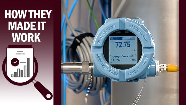

Emerson designed the Rosemount 3144S temperature transmitter to address common temperature-measurement challenges and industry trends in the chemical processing industry.
The transmitter provides 0.05°C accuracy and 20-year stability to ensure valid and consistent measurements. The transmitter also offers extended calibration intervals to reduce trips to the field.
Measurement reliability was further enhanced with complete diagnostic coverage from the sensor to the control room for real-time insight into each measurement point while minimizing downtime.
Emerson designed the Rosemount 3144S with user-friendly features, such as Bluetooth connectivity and plug-and-play sensor configuration, to meet the needs of the current workforce as more experienced workers retire.

  • ±0.05°C accuracy
  • 20-year stability specification and a 20-year warranty.
  • ReadyConnect technology for plug-and-play sensor configuration
  • Interface with Bluetooth wireless connectivity a task-based menu structure and a customizable backlit LCD display for enhanced readability and consistent user experience across communication tools
  • Rosemount X-well technology for non-intrusive temperature measurement up to 650°C, eliminating the need for thermowells
  • Full diagnostic coverage from sensor to control room
  • Loop Integrity, which continuously monitors for hidden electrical issues
  • RTD measurement protection, which automatically switches from 4-wire to 3-wire RTD input configuration if a wire becomes compromised anywhere from the sensor element to the transmitter terminal connections
