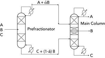

Prefractionator
Figure 1. Adding such a column typically leads to a 20–40% cut in energy consumption.

Converting An Existing Sequence
If the infrastructure already exists to perform the separation by conventional methods, you may be able to convert the current sequence to a prefractionator or Petlyuk arrangement (Figure 1). This can save a significant amount of energy for the required separation; typically, it reduces energy consumption by 20–40%. Alternatively, you can produce more products from the facility for the same amount of energy.
Converting an existing facility from a conventional sequence to a prefractionation one certainly isn’t trivial; it requires careful study, including rigorous simulation, and then a detailed evaluation of the mechanical modifications necessary. You should assess, e.g., the internal tower hardware before and after the modifications, suitability of the pre-fractionator reboiler and condenser in the new service, turndown capability in the new service, and other details.

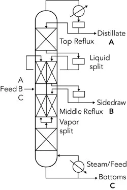

Dividing Wall Column
Figure 2. Existing towers with low-volume overheads or bottoms often are good candidates for conversion.
A further way to achieve or increase energy savings is by converting the sequence to sequences that employ side-rectifiers or side-strippers.
Opting For A Single Dividing Wall
A dividing wall column (DWC) may save a substantial amount of energy. (See: “Consider Dividing Wall Columns,”[2].)Depending on whether significant changes in product mix or capacity requirements have occurred over time, it may be possible to convert a two-tower system to a single dividing wall column (Figure 2). This is more likely when the original tower configuration was developed to remove relatively small fractions of light component (A) or heavy component (C) or both.
You must assess mechanical details such as tower hydraulics, feed locations and auxiliary equipment rating as well as other details to determine the feasibility of such a conversion. As with all complex column configurations, it’s essential to remember that the levels of energy consumption are an important consideration for the evaluation of the benefits of new separation configurations. While the single DWC will consume less energy from a First Law perspective, it maybe disadvantaged from a Second Law perspective. So, you must analyze the system individually, taking into account the utilities and economics for the particular operation or entity.
