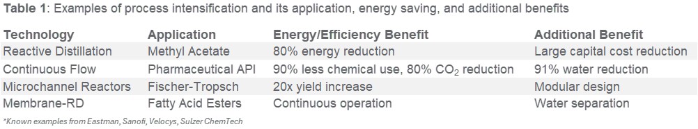

Furthermore, DOE didn't pull that $9 billion figure from thin air. The agency’s analysis identified 695 TBtu/year of potential energy savings using proven technologies, not laboratory or early-stage technology. We're talking about real equipment in real plants generating real profits (see Table 1: Examples of process intensification).

Capital constraints can create another speed bump. Even if paybacks hit one to three years, the upfront check still needs signing. Smart operators have cracked this code through phased implementation. Consider starting with lower-risk technologies like dividing wall columns, bank those savings, then reinvest in other, potentially more advanced technologies (see Table 2: Basic checklist for process implementation).
