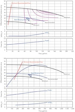

Pump Curves
Figure 1. A major problem often encountered is operation away from the BEP.Source: Blackmer – North America.
When selecting between two particular pumps, try to choose the one with the greatest distance between its maximum and minimum wheel (impeller) size shown on the pump curve. Specifying a pump with a wheel diameter nears its minimum means you can't shave the impeller down to adapt to process changes. Installing the largest possible wheel means you can't debottleneck the process later by increasing the wheel diameter, and will need to purchase a new pump.
Comparing pump curves requires engineering judgment and experience. Sometimes, though, the choice is clear. For instance, Figure 1 shows curves for two pumps — one, an A-Frame, with a recommended wheel of 9.25 inches; the other, an S-Frame, with a 6.13-inch wheel. Both pumps will operate at the same flow rates when compared to the system curve. However, the larger A-Frame pump has an impeller only 0.25 inch larger than the minimum size for that pump. In contrast, the impeller for the S-Frame is about halfway between the minimum and maximum sizes. Clearly, the S-Frame Pump provides more flexibility to accommodate changes.
A smaller wheel has a higher NPSHR and lower required power draw, but is less efficient. The larger the wheel is, the more efficient the pump if you can operate near or at the Best Efficiency Point (BEP), indicated by the triangular areas on Figure 1. While you shouldn't ignore efficiency in pump selection, BEP operation, shaft length (L) and diameter (D), needed horsepower, NPSHR and process adaptability typically dominate design criteria.

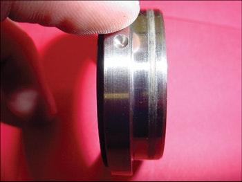

Fretting
Figure 2. Damage to shaft sleeve resulted from shaft deflection.Source: A. W. Chesterton
Filtration is an example of a pump running across the curve during required operation. The pump starts at a high flow rate and low head. As the cake builds, discharge head increases. So, it's impossible to design a centrifugal pump to operate at the BEP in this application. This can result in vibration on both sides of the BEP and significant shaft deflection problems.
SHAFT DEFLECTION
Operating to the left or right of the BEP imposes force loads on the shaft. These unbalanced loads cause shaft deflection, vibration and premature bearing and seal failure. Operating to the far right of the BEP also can induce cavitation.
The most effective way to deal with shaft deflection problems is to increase shaft stiffness, which is inversely proportional to L3/D4. The ratio should be less than 60.
Nearly all pump shafts are made of metal. As the pump runs across the curve, it will deflect if ever so slightly. The modulus of elasticity varies, but not much. So, changing material of construction is of little use to increase rigidity.
Shaft sleeves don't add stiffness to a shaft. They are a weight (force) riding on the shaft just like the wheel. They detract from the shaft's L3/D4 and reduce rigidity. Don't use the diameter of the sleeve in the L3/D4 calculation.
Shaft sleeves came into use for one reason — to combat fretting-induced leaks. Packing and lip seals damaged pump shafts. The sleeve was developed so the shaft didn't have to be thrown away. In the absence of packing it has no value. Actually, having a sleeve can increase the cost of a pump because standard shafts must be machined down to accommodate the sleeve.
No sealed pump should have shaft sleeves. Also, use labyrinth seals instead of lip seals.
