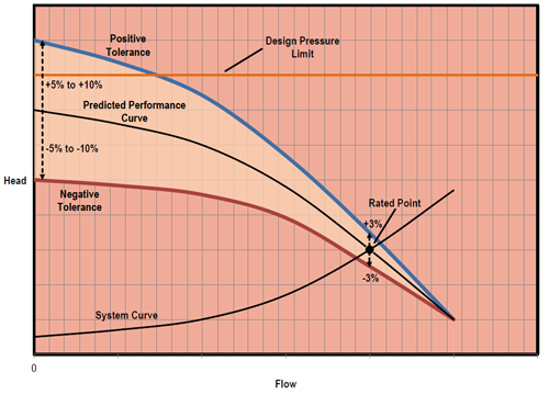

Scenario 1: Positive tolerance at pump shutoff exceeds system design pressure. The pump shutoff head typically is selected such that it won’t exceed design pressures of downstream systems. In certain revamp scenarios to avoid changing piping classes, rerating the piping/vessels or adding a pressure safety valve/high-integrity pressure protection system may be necessary to avoid exceeding design pressure. The proposed pump may be acceptable per the predicted shutoff head — but once the API-610 tolerances are applied, the actual shutoff head could be 5 to 10% higher. Figure 1 illustrates how the allowable positive tolerance at shutoff can cause a certified performance curve to exceed the design limits of an existing system.
In this scenario, the pump impeller would need to be retrimmed and the pump retested to ensure the system design limits aren’t exceeded. This also may impact the rated performance and feasibility of the selected pump.

Figure 1. Positive tolerance at shutoff may lead to head that exceeds system design.
Scenario 2: Negative tolerance at rated point results in an underperforming pump. Without considering the allowable tolerances of the rated head, the performance of the preliminary curve may appear acceptable. However, a negative deviation of the rated head may lead to a pump that underperforms. For example, a high-head cavern injection pump may require a rated head of around 2,500 m. API-610 allows a tolerance of ±3% of the rated head. If the certified pump has rated head 3% less than the predicted curve, then the pump could lose up to 75 m of developed head. In typical liquefied-petroleum-gas service, this can result in a loss of up to 370 kPa of developed head, which may be significant. The process engineer should consider the potential for reduced head and determine if the system has sufficient hydraulic capacity to absorb deviations between the predicted and certified performance. Figure 2 illustrates how the allowable negative tolerance at the rated point can cause a certified performance curve to fail to meet pressure requirements.
If the system lacks sufficient hydraulic capacity, the pump impeller either would need to be replaced and retested, or a reduced flow may need to be accepted. However, depending upon the design limitations of the system, replacing the impeller to gain head could lead to exceeding the system’s design pressure at pump shutoff.
Inadequate Head Issue
Figure 2. Negative tolerance at rated flow may mean pump doesn’t provide sufficient head.
