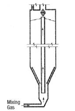

The lift tube blender (Figure 6) utilizes a central pneumatic-operated tube in a silo, often with a cone-in-cone hopper to increase the relative velocity of the individual solid particles. Conveying rates can greatly exceed those reached in a conventional pneumatic convey line (200,000 lb/hr isn’t unusual). Lack of impingement of the particles on elbows can minimize attrition. Dedusting of the product can occur during blending. The solids need to be free flowing.
Figure 6. Unit can provide much higher rates than possible with pneumatic conveyors.
It’s possible to blend small amounts of fine particles by introducing them into the gas that enters the bottom of the blender via a venturi. The only limitation is that these particles need to be large enough not to get blown out of the silo and small enough not to plug the ejector feed. The venturi can be used in a convey line to blend on the fly without recirculation to the tank. The pressure at the inlet of the venturi will control the rate of injection of the second solid.
