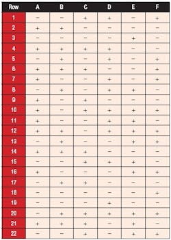

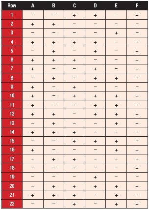

Designs for up to 50 factors can be readily laid out via commercially available statistical software developed specifically for experimenters [4]. A sample layout for six runs is provided in the Table 3.
Table 3. The MR5 layout for six factors in case study: + means the factor is increased; - means it is decreased.
It codes the lows as – (minus) and highs as + (plus). If you perform this experiment, we recommend that the rows be randomized for your actual run order. If the number of runs far exceed your budget for time and materials, choose the option for MR4 (minimum run resolution four) — well enough to screen main effects. As shown in Table 3, these lesser-resolution designs require a number of runs equal to two times the factors, for example: 20 runs for 10 factors (versus 56 for the MR5 and 1,024 for all combinations in the full-factorial).
