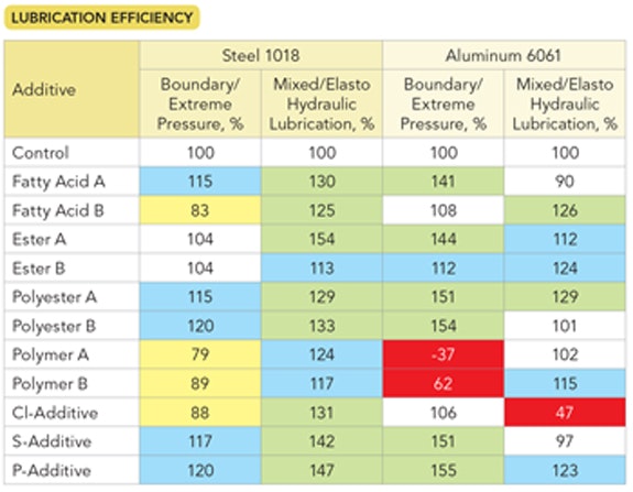

The first stage in the development process for a new cutting fluid is to investigate individual lubricity additives that reduce friction between the cutting tool and workpiece. In this case, Houghton used one factor at a time (OFAT) studies to screen potential additives. We determined the performance of these additives by measuring the coefficient of friction between a test specimen and a pin with the additive applied. Comparing the measured coefficients of friction to a control value gave relative lubrication efficiency. Our chemists tested each selected lubricity additive on different metals and at different application conditions (Table 1). From the test results, we selected lubricity additives for the new formulations based on their ability to provide good lubricity on steel or aluminum or both.
Lubrication Efficiency
Table 1. Comparison versus a control highlighted the dramatic differences in additives’ performance for steel and aluminum.
Typically, the lubricity package of a cutting fluid includes a number of additives. With many different possible additives to consider, Houghton chemists in the past relied on OFAT methods to identify the right formulation for a new product. This approach provides a quick way to get a rough comparative measurement of additive performance. The problem with OFAT at this stage is that it requires three or four repeats of tests or measurements to evaluate the effects of each additive. However, even after performing these tests, chemists are unsure if the difference in performance between various additives is statistically significant. They also have no way to understand possible interactions between the additives without running many more samples. As a result, this approach is time-consuming and leaves chemists uncertain about whether they have achieved the best formulation.
