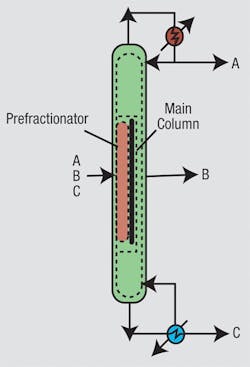

Distillation system design also is attracting increasing attention. Before we get into this, it is useful to distinguish between simple and complex columns. A simple column has a reboiler and a condenser, and splits a single feed into two products. Although different configurations are possible when using simple columns, the design problem still is a manageable size. However, separations often require more complex arrangements, including thermal coupling, side strippers, side rectifiers, prefractionators and dividing-wall columns (Figure 5). As the number of products increases, the number of possible complex column configurations explodes. In addition to this problem, we need to choose the most appropriate pressure for each separation in a complex arrangement and to consider heat integration simultaneously.Figure 5. Complex distillation
