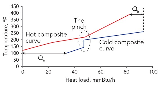

We all learned as children that heat flows from hot objects to cold ones. This simple concept is the basis of the hot and cold composite curves (Figure 1) that represent the overall heat release and heat demand of a process as a function of temperature.
The hot composite curve is the sum of all the heat sources (or “hot streams”) within the process, defined by their heat load and temperature level. The cold composite curve is the corresponding sum of all the heat sinks (or “cold streams”). We plot these curves together on a single temperature-enthalpy graph (as in Figure 1), from which we can see heat can be recovered within the process wherever the hot composite curve is above the cold composite curve — that is, heat can flow from a higher-temperature part of the process to a lower-temperature part. The heat flow takes place in heat exchangers, whose sizes increase as the temperature difference decreases. We therefore specify a minimum allowable temperature difference, ΔTmin, to ensure the equipment size doesn’t become too large.
Most composite curves show a pinch where the vertical separation of the curves approaches and eventually reaches the ΔTmin value. The pinch divides the process into two distinct regions:
• Above the pinch, some heat integration is possible (where the hot composite curve sits above the cold composite curve), but a net heat deficit exists, mandating an external utility heat source (Qh).
• Below the pinch, some heat integration is possible (where the hot composite curve sits above the cold composite curve), but a net heat surplus exists, mandating an external utility heat sink (Qc).
Hot and Cold Composite Curves
Figure 1. The curves represent the overall heat release and heat demand of a process as a function of temperature.
If we allow heat to flow from the region above the pinch, where a deficit of heat prevails, to the region below it, where a surplus occurs, both the deficit and the surplus will increase. So, we need more hot and cold utility duty to satisfy the process heat balance, and must consume more energy. This leads to the pinch principle: Don’t transfer heat across the pinch.
