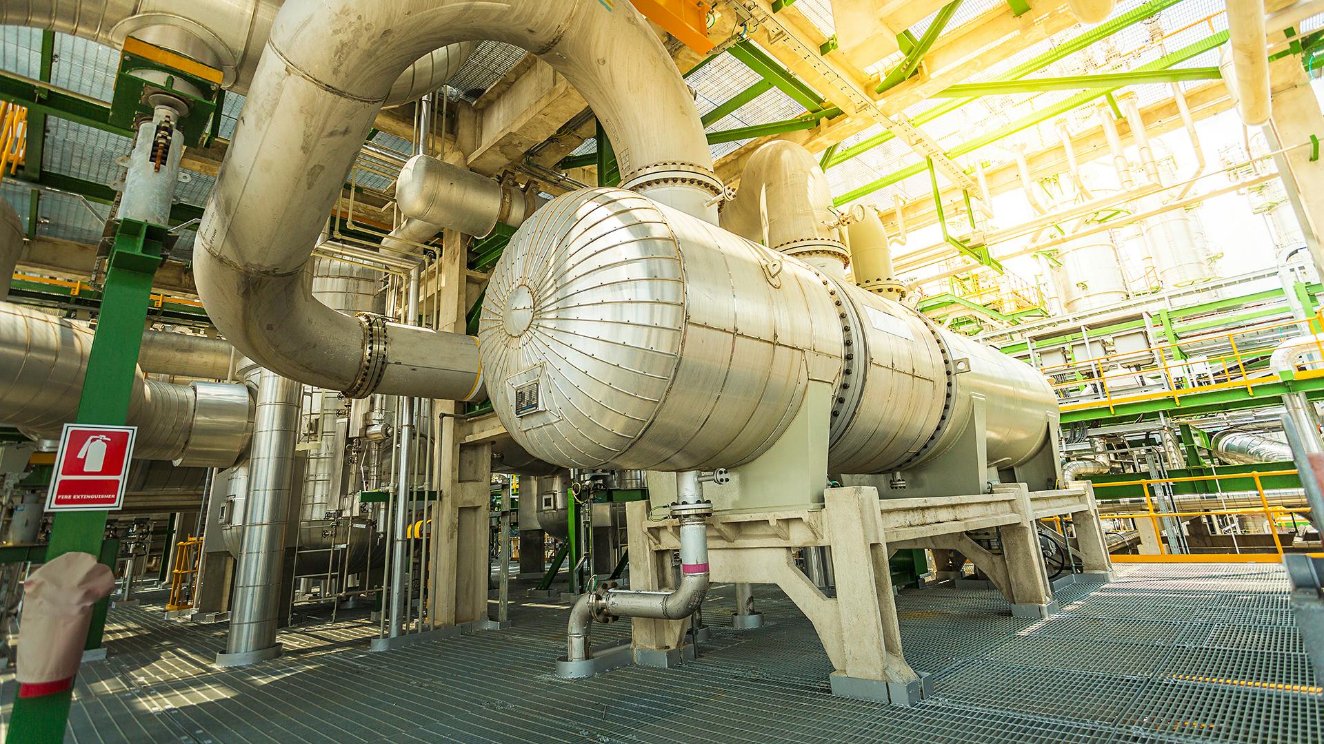

When a kettle reboiler failed to meet its duty requirements, what initially appeared as a simple performance issue turned into something else. Figure 1 illustrates one common kettle reboiler configuration.

In one reboiler that could not do the required duty, the operators observed low liquid levels in the tower simultaneously. Experimentation in the field showed additional interesting behavior. As the liquid level in the exchanger was changed, duty changed. The most likely reason duty was changing was that the liquid level on both sides of the reboiler overflow weir is changing. Figure 2 illustrates this operation. For clarity, Figure 2 shows a lower liquid level in the kettle liquid than Figure 1.
A hole in the baffle between the tube-bundle compartment and the still liquid compartment in the kettle has grown large enough that the liquid in the kettle no longer overflows the internal weir. Part of the exchanger bundle is dry and doing very little duty.
The pressure balance caused the level in the tower to change at the same time as the level in the changed in the reboiler.
Thermal imaging of the exchanger clearly showed the level of boiling liquid below the weir. A field test of increasing the liquid level showed reboiler duty increased and the level of the boiling liquid in the exchanger increased. Regretfully, the level taps on the exchanger had a reduced range and the upper tap was installed below the level of the overflow weir. This prevented a straightforward change in level settings on the reboiler from being an effective temporary operation.
Instead, the level control was shifted to the tower boot, as shown in Figure 3. With this operation, the reboiler tube bundle was fully wet and could meet the required duty.
