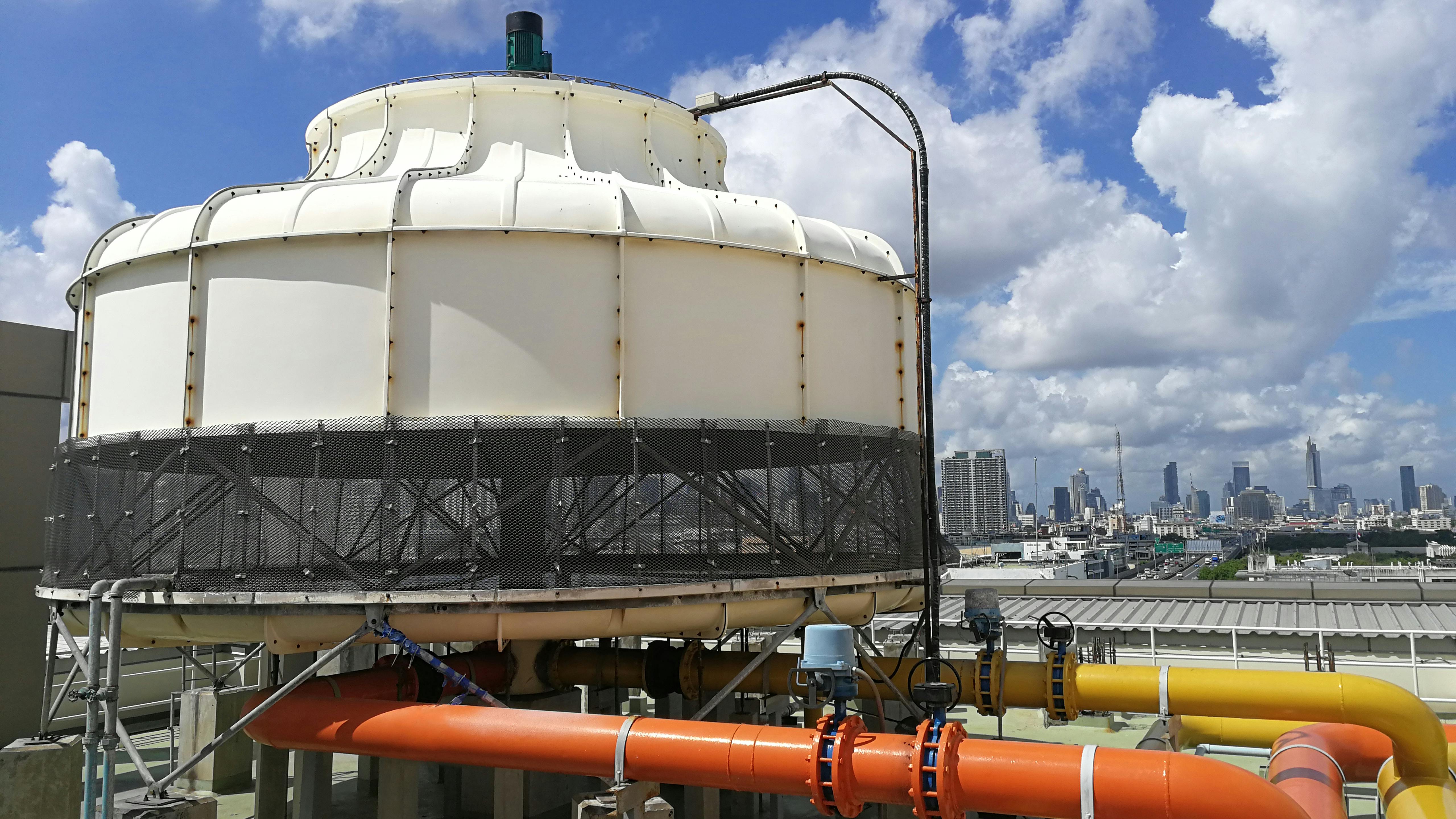

While numerous cooling tower designs, including hybrid variations, have evolved over the decades, the two most common types are counterflow and crossflow mechanical draft towers, shown respectively in Figures 2 and 3.
Counterflow towers are more common than crossflow towers now because of better efficiency and lower pump head, but the crossflow design is still useful, especially in applications where the makeup/recirculating water has a high fouling potential. Most large industrial towers are induced draft, where the fans pull air through the tower rather than pushing it through.

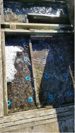

Regular inspections will reveal plugged, damaged or missing nozzles that reduce tower efficiency and allow channeling of air and water through the fill.
In crossflow towers, the return water is typically discharged onto a distribution deck with uniformly spaced nozzles within the deck that allows the water to feed by gravity onto the fill.
Logic of course suggests the importance of keeping all nozzles clear to maintain uniform flow to the fill. In this case, an added problem may arise from algae that can proliferate in sunlit areas of the tower. Covered decks are common to minimize algae growth.
