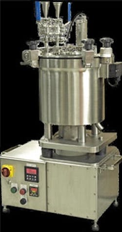

The Western States Machine Company's Laboratory Filtering Centrifuge is designed for solids/liquid separation; is engineered for the washing and extraction of food ingredients, polysaccharides, crystals, botanical extracts and pharmaceuticals; and is rugged enough to handle dense products including powdered metals. Separate feed and wash lines allow approximation of production scale centrifugation process.
Basket Capacity and Design:
  • Machined from a solid block of 316 stainless steel
  • Six inches in diameter x 3.6 inches high x one inch cap
  • Solids holding capacity: 41 in3 (677 cm3, 0.68 liters)
  • Filtration surface area: 34 in2 (219 cm2)
  • Filtration medium: can be used with polypropylene or nylon filter cloth or paper filters
  • Separation force: 1,360 gravities
  • Speed: 0-4,000 rpm
  • Basket removal: keyed shaft with rare earth magnet requires no tools for basket removal (patent pending)
Housing:
  • 316L stainless steel with welds ground flush with 180 grit (30 RA) polish inside and out
  • 6° sloped bottom and one-inch, tri-clamp ferrule allow for complete liquid drainage
  • Vapor-tight (no pressure) vessel with easily removable O-ring seal and four clamps
  • Spring-assist, easy-lift hinged cover with safety interlock prevents opening of cover while basket is rotating
  • One slurry feed and one wash pipe — 1/2-inch ball valves and tri-clamp fittings
  • Sight glass located over the center of the basket
  • Sanitary halogen light
Controls:
  • NEMA-4X electrical enclosure and base frame
  • Variable frequency drive — 0-4,000 rpm
  • Motor 1/2 hp TENV
  • Heavy-duty bearings isolate motor from basket load
  • Start/stop push buttons
  • Digital speed control and actual RPM display
  • Digital timer for run time
  • Power disconnect
  • 110 volt, one-phase power supply (12 amps max)
  • Approximate weight: 220 pounds
