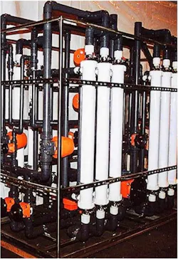

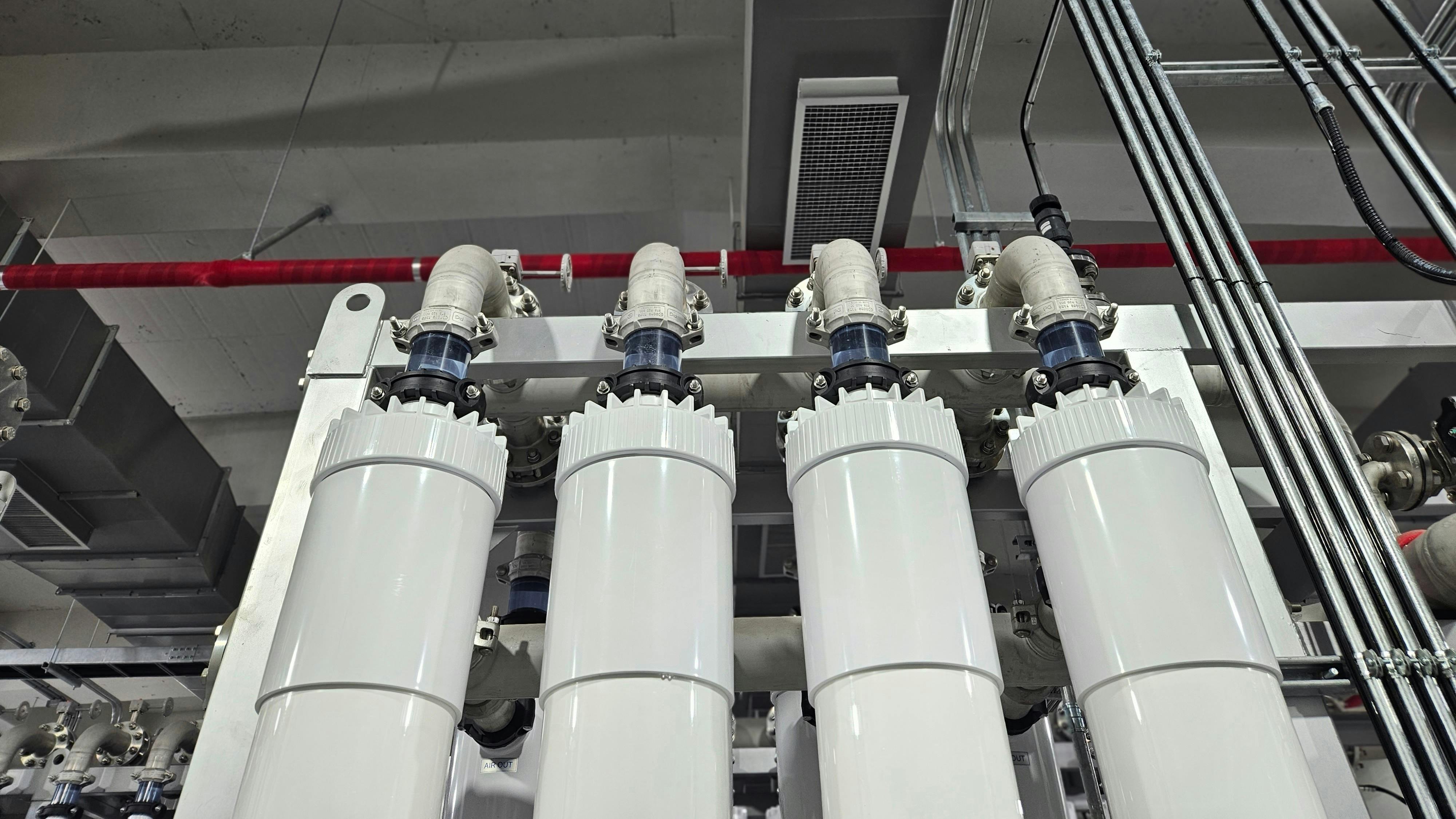

As Figure 3 indicates, MF, and especially UF, can remove much smaller particles than clarification-filtration. The most common designs have pressure vessels operating in parallel.

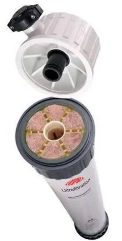

Each pressure vessel is filled with thousands of spaghetti-like hollow fiber membranes (Figure 5a and 5b).
The process operates via a combination of crossflow and dead-end filtration in which the raw water flows parallel to the membrane surfaces. Water continually passes through the membranes on its flow through each pressure vessel, but many particles remain in the small reject stream that exits the vessels.
Both outside-in and inside-out permeate flow paths are possible, though the outside-in process seems to be more common. Even though UF can remove very fine particles, pore sizes are still much larger than those in RO membranes, so corresponding inlet pressures and feed pump requirements are much lower than for RO.
Some particulates continually collect in the membranes, and this debris must be periodically removed via an air enhanced backwash process. A representative cycling time might be 20 minutes of water production followed by a one-minute air scrub/reverse flush step to remove embedded solids.
