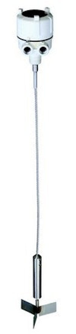

Flexible shaft extension can be used when the rotary is mounted on the top of the vessel and used for high-level detection.

This extension can be used when the rotary is mounted on the top of the vessel and used for high-level detection. The single, flexible 8-mm cable attached to the rotary power pac shaft must be a minimum of four inches and a maximum of 14 feet long.
An 8-inch counterweight at the end of the cable includes a coupler for attaching the paddle. To configure the rotary, the length of the counterweight, coupler and paddle must be added to the length of the cable.
