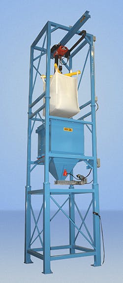

Material Transfer system discharges materials from bulk bags with or without outlet spouts into customer's existing process.
The Material Master Bulk Bag Discharging System with bag piercing knives discharges materials from bulk bags with or without outlet spouts into a customer's existing process. The system uses a 2-ton chain hoist with VFD to lift a bulk bag into a carbon steel discharge hopper. A stainless steel static bag piercing knife assembly completely empties bulk bags. The hopper features a full perimeter dust plenum with dust take off stub for product dust control. The hopper includes a pneumatic vibrator system to assist with product flow and an air actuated gate valve mounted at the bottom of hopper for product flow control. Removable side panels and a custom knife guard enhance operator access and safety during maintenance.
