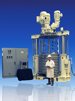

The Ross line of VersaMix Multi-Shaft Mixers process medium to high-viscosity applications up to several hundred thousand centipoise including many slurries, pastes, gels and suspensions. The 500-gallon VersaMix is equipped with a custom combination of independently-driven agitators. The anchor agitator with helical flights and the screw auger agitator work in tandem to promote efficient product turnover while bringing air pockets to the surface. Two saw-tooth high speed disperser blades impart shear for fast powder wet-out and thorough deagglomeration.
The VMC-500 also features special air casters for convenient mobility of the mix vessel, PLC recipe controls with data acquisition capabilities and a purged explosion-proof operator station.
