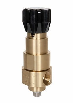

Cashco introduced the B7 High Flow/High-Sensitivity Back Pressure Relief Regulator.
The Model  B7 High-Flow/High-Sensitivity Back Pressure Relief Regulator is suitable for use in high-pressure applications that require back pressure relief to avoid setting off a safety relief valve, including hyperbaric chambers, air compressors, pressurized ballast tanks, high pressure testing, life support applications, manifold systems, tube trailers and gas transfer stations.
The B7 back pressure relief valve is available in ½-inch and 3/4-inch sizes with a brass or stainless steel body. The Model B7, which is designed to control inlet set point pressure levels between 10-1150 psig (.69-79.3 Barg), is also available in angle, globe and flow-thru configurations with end connection options of NPT, 300 lb. flanges, 600 lb. flanges and 1500 lb. flanges.
