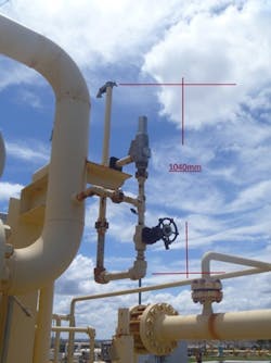

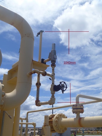

Pressure Relief Valve
Figure 1. When open, this valve vents fluid to atmosphere.
