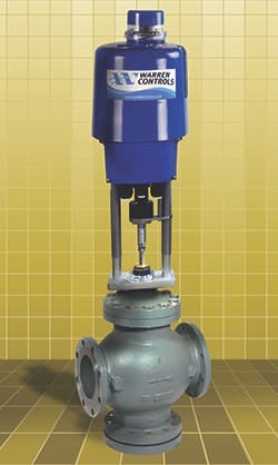

Warren Controls introduces its new ILEA 1800E Series electrically actuated, high capacity, general purpose, globe control valves. Series 1800 E Heavy Globe Control Valves features rugged high capacity bodies of iron, steel or stainless steel with a variety of trim materials and sizes. The equal percentage and linear plugs in the 2-way valves and linear plugs in the 3-way valves provide excellent modulating control of a wide variety of fluids, according to the company.
Series models are capable of handling temperatures from -20 to 8000F, severe service, high pressure drops and corrosive fluids. Valve sizes range from 2½ to 12 inches, with many models including a USB port. Warren Controls also offers options to customize the valves.
Available styles are 2-way balanced, 2-way unbalance, 3-way mixing and 3-way diverting. Eleven models are in stock – with dozens of other models available with a 4-week delay on the order cycle, according to the company
