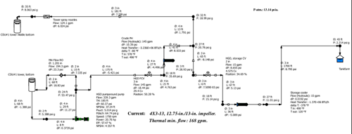

At our refinery, the mechanical seals on the pump in the heavy gas oil (HGO) pump-around on the pipe still (Figure 1) failed about once every two years. The pump manufacturer told us the pump, which delivers 339 gpm, wasn’t operating within its most efficient range and would experience fewer problems if we moved the operating point closer to the best operating point. So, a year ago, we trimmed the pump’s impeller to 11.75 in. from 12.75 in. We also increased the minimum-flow restrictive orifice (RO) diameter to maintain 194-gpm flow. Before trimming, the 4-in. control valve ran at 50%; initially after trimming, it ran at 67% — but this has been creeping up ever since and now is at 73%. A month back, we started to notice poor distribution in the return line to the crude distillation unit (CDU). The pressure drop across the spray nozzles should be about 6 psi but now reaches 9 psi. Is the trimming causing our problems? Should we go back to the old impeller? Can we increase the RO diameter to reduce wear on the seals even more? What other symptoms should we look for? What’s our path forward?
Pump-Around System
Figure 1. Recurring problems with seal failure led to trimming the pump’s impeller but other issues now have arisen.
