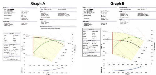

At our refinery, the mechanical seals on the pump in the heavy gas oil (HGO) pump-around on the pipe still (see figure) failed about once every two years. The pump manufacturer told us the pump, which delivers 339 gpm, wasn’t operating within its most efficient range and would experience fewer problems if we moved the operating point closer to the best operating point. So, a year ago, we trimmed the pump’s impeller to 11.75 in. from 12.75 in. We also increased the minimum-flow restrictive orifice (RO) diameter to maintain 194-gpm flow. Before trimming, the 4-in. control valve ran at 50%; initially after trimming, it ran at 67% — but this has been creeping up ever since and now is at 73%. A month back, we started to notice poor distribution in the return line to the crude distillation unit (CDU). The pressure drop across the spray nozzles should be about 6 psi but now reaches 9 psi. Is the trimming causing our problems? Should we go back to the old impeller? Can we increase the RO diameter to reduce wear on the seals even more? What other symptoms should we look for? What’s our path forward?

Trimming the pump impeller and increasing the recirculation rate through the restriction orifice will reduce the pump discharge head. Therefore, the extra opening in the flow control valve (from 50% to 67%) is in the expected direction.

It’s too early to know if the pump manufacturer was correct about trimming the impeller because seal failure only happens every two years. If you have some downtime, you could pull the seals for inspection but this may tell you nothing. Wait and see. Clearly the current problem has nothing to do with seal failure. See Figure 1 a and b.

Figure 1. After impeller trimming, the pump operates far closer to its best efficiency point.
