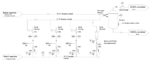

I’m a new-hire production engineer at an ethylene oxide plant. I graduated last year and just finished my probation period, winning my white hat. I went over the production logs a few weeks after I got here and found a real problem: the pressure relief valves (PRVs) keep popping every few months. I wanted to say something right away but, being a new graduate, I didn’t want to question a situation that others already have scrutinized. Recently, though, I talked to the operator on shift at the time of the last PRV release. He said the operators rely on an “automatic” manual vent (one with a lift ball) to prevent the PRVs from opening (Figure 1).
Vent Header
Figure 1. Pressure relief valves have popped about three times per year recently.
I then spoke to a few more operators. They all told me they’re so busy since a plant expansion that they have trouble controlling the reactor pressures; sometimes they just let the vent catch the upsets. The PRVs only pop every so often, one said. The foreman advised me drop the matter.
However, I looked more into it and found the manual vent opened every few days and the PRVs have popped about three times a year over the past two years. I can’t get more data because the trends only go back that far. Interestingly, I talked to accounting and discovered we use twice as much sulfuric acid in the scrubber as we did two years ago.
I dug into our files and couldn’t find the sizing calculations for the vent. I don’t think this vent is even legal. What should I do?
