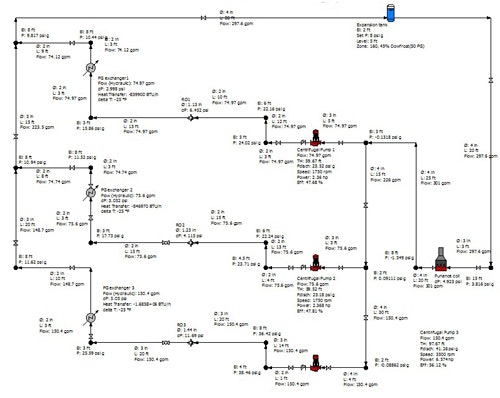

We design anaerobic digester systems for clients who use the generated methane for power. In addition, we operate some facilities. Our design relies on spiral heat exchangers that have a solution of 50% propylene glycol and water (PG/aq.) on one side and sludge or manure on the other side. The manure is heated to 110°F by PG/aq. at 185°F–160°F.
We’re suffering a lot of problems with our design, especially the heat exchanger loop (see Figure 1). One problem is poor heat transfer because some manure has migrated to the glycol side; this also is a safety issue because the glycol system is closed. In addition, we’re under scrutiny by the U.S. Environmental Protection Agency because of hydrogen sulfide emissions.
Anaerobic Digestion Heating System
Figure 1. Leak of manure into propylene-glycol/water side of spiral exchanger impairs heat transfer and poses safety issue.
The people in our operations group are certain the culprit is poor welding in the exchangers; they can’t see how leaks can be detected in the spiral exchangers. So, they have persuaded management to switch to a shell-and-tube exchanger with one shell pass (manure) and two tube passes (glycol solution). I’m not convinced about the design and don’t think operations has proved their point — what do you think? Is that shell-and-tube exchanger a better choice than the spiral?
